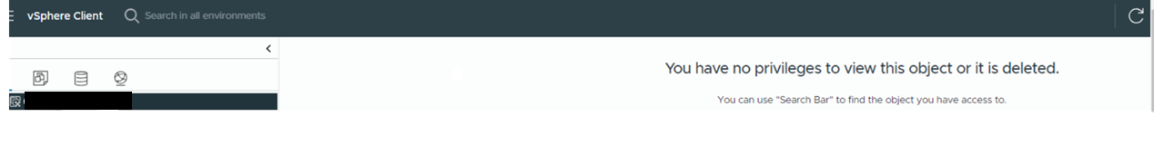

  • Browsing the inventory may error with errors such as "You have no privileges to view this object or it is deleted" as follows,
