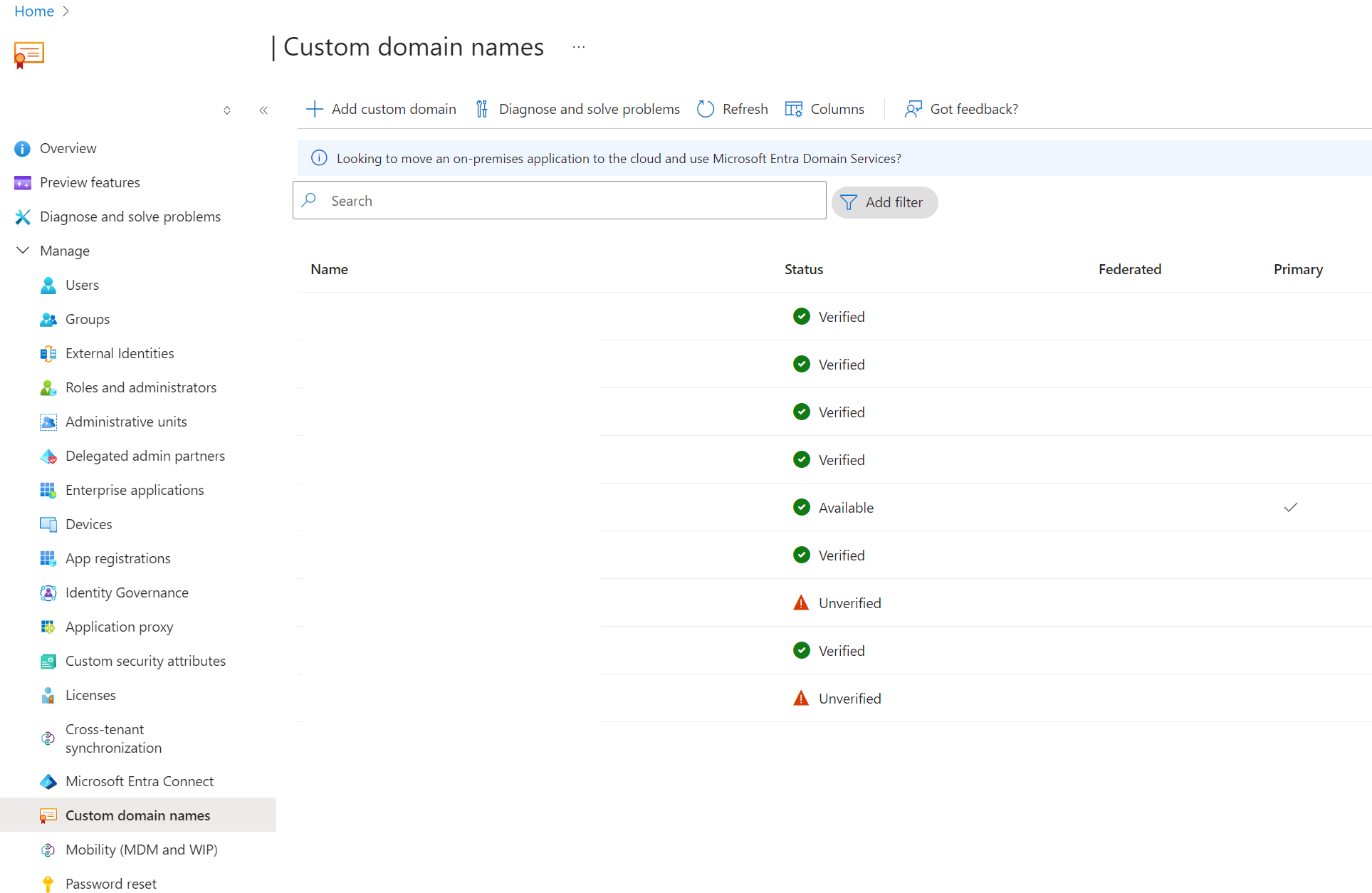

Please submit a support request outlining which domains you require to be claimed for the application, and pass back a screenshot of the domains within Entra ID via:
  1. Open Azure Portal
  2. Open Entra ID
  3. Select Custom Domain Names from the left nav
  4. Search on the domain(s) you wish to claim and pass back a screenshot alongside you request to validate the domain is claimed within your Azure Tenancy.
Support will then claim the domains on your behalf via an internal tool.
