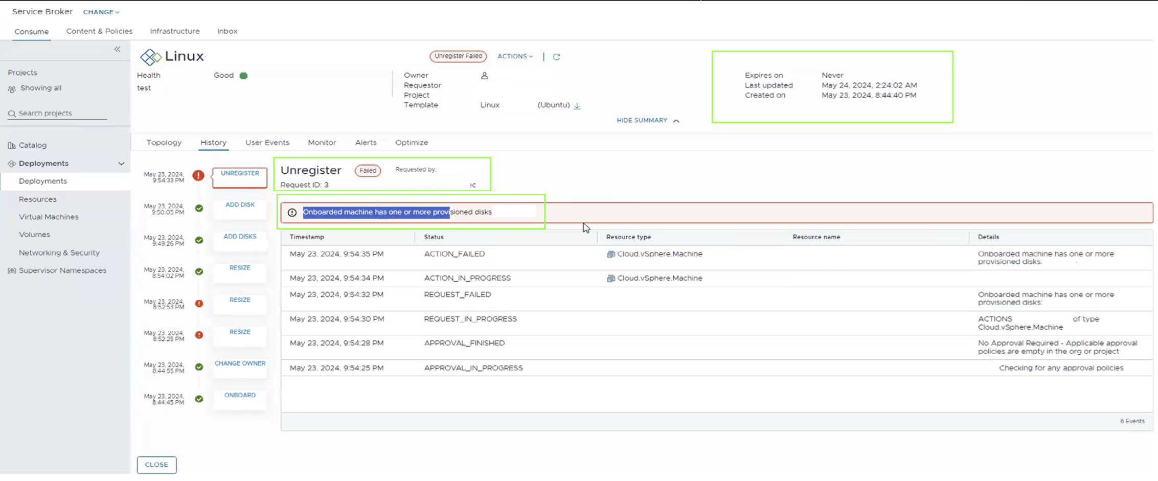

  • This article describes a scenario where Unregistering a VM in Aria Automation fails with "Onboarded machine has one or more provisioned disks" error as shown below.
  • Aria Automation 8.16.2
  • Aria Automation 8.18
  • The error is due to the default 'false' value of ' enable.unregister.provisioned.machine ' toggle which will be removed in the upcoming release, and hence ensures that the unregister will be invoked irrespective of VM being in provisioned, onboarded or mixed state.
  • Also the existing verifyDisks validation method will also be removed since we no longer intend to stop unregister action on machines with provisioned disks, since the state of such disk(s) will be moved back to discovered in revertDisk method.

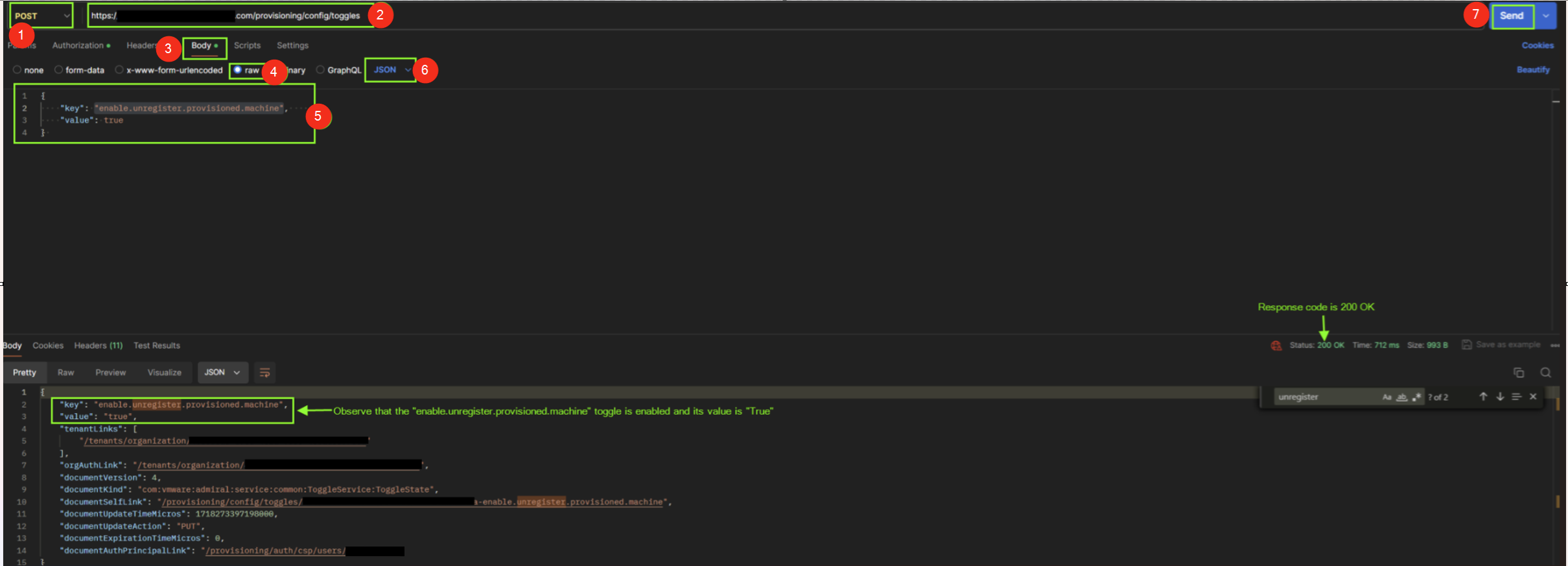

  • Capture the Bearer Token from Aria Automation ui as shown in the Screenshot
  • Use Postman and execute the GET call on https://<VRA_FQDN>/provisioning/config/toggles with Auth Token as “Bearer Token” and Body as “JSON”
  • Search for ‘unregister’ to see if the "enable.unregister.provisioned.machine" toggle is already available in the Toggle list. If not available, then it implies that the Unregister toggle is not enabled
  • Once verified, use POST call to enable "enable.unregister.provisioned.machine" toggle
  • After following the above steps, “Unregister” the VM to successfully unregister it from Aria Automation

  • Execute the below curl command from Aria Automation SSH session.
    • curl --location --request POST 'https:// <VRA_FQDN>/provisioning/config/toggles?expand=true' \
      --header 'Content-Type: application/json' \
      --header 'Authorization: ••••••' \
      --data '{
      "key": "enable.unregister.provisioned.machine",
      "value": true
