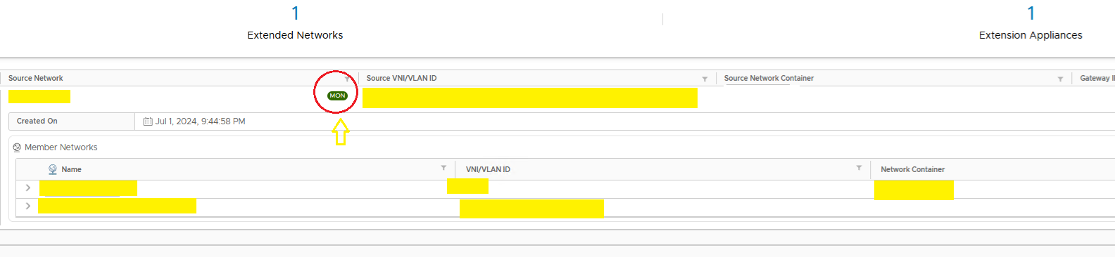

  • Log in to HCX hybridity page and navigate to Network Extension.

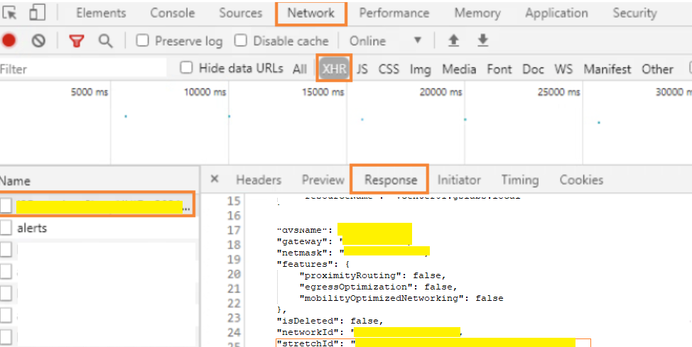

  • Open the developer tools on the browser.
  • Select Network -> XHR and l2E from the name window and collect the information from the Response tab related to the L2E that MON needs to be enabled.
  • Copy the whole response output to a "Notepad ++" and search for the VLANID and its corresponding stretchId that you want to enable MON.

On the HCX hybridity page, you will see MON option highlighted on the Network Segment.
