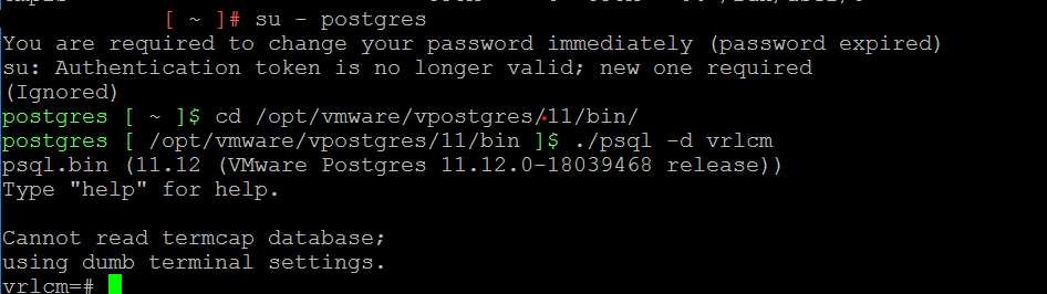

    2. Cleaning up tables in the Aria Suite Lifecycle DB:
      • This method would only be possible if the postgres service is running and the '/storage' partition is not at 100% utilization.
        1. Ensure valid snapshot and backups are in place.
        2. Log in to the Aria Suite Lifecycle Appliance using root credentials.
        3. Connect to the Aria Suite Lifecycle DB:
          su - postgres
          cd /opt/vmware/vpostgres/11/bin
          ./psql -d vrlcm
        4. Run VACUUM FULL VERBOSE ANALYZE vm_rs_request; to clean up DB.
        5. run \q to quit the database
        6. exit the psql bash.
        7. Validate that the UI is accessible.
