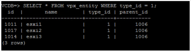

  1. Run this query:
    SELECT * FROM vpx_entity WHERE type_id = 1;
  1. Make a note of the hosts and their associated ID field displayed in the query results.

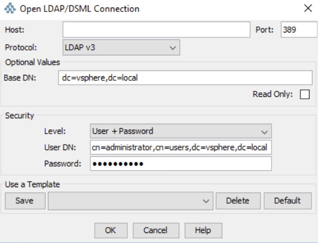

  2. Download and install JXplorer, available at JXplorer.
  3. Open JXplorer and select File > Connect.
  4. In the Open LDAP/DSML pane, make these configuration changes:
    1. For host, enter the FQDN of your Platform Services Controller.
    2. The Port should be 389 or 11711.
    3. The protocol is LDAP v3.
    4. Base DN will be dc=vsphere,dc=local.
Note: If you are using a custom vCenter Single Sign-on domain name, you have to replace vsphere and local with the name of your custom domain name. For example, if you chose vsphere.vmware.corp as your vCenter Single Sign-on domain, the value would be: dc=vsphere,dc=vmware,dc=corp
  1. The Security Level will be User + Password.
  2. The Security User DN will be cn=administrator,cn=users,dc=vsphere,dc=local.
  3. The Security Password will be your administrator password for your vCenter Single Sign-on administrator account.
