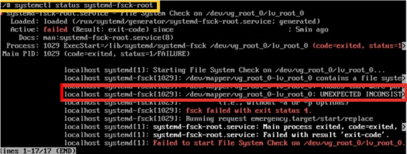

    At the end of the line, add systemd.unit=emergency.target then press F10 to continue booting the appliance.
      1. Find the affected filesystem:
        systemctl status systemd-fsck-root
      2. Run the fsck command against the mount point that has the issue:
        fsck -y /dev/<mount>
        Note: The "-y" switch fixes the nodes automatically. Replace <mount> with the mount point experiencing the issue.
        fsck -y /dev/mapper/vg_root_0-lv_root_0
        Alternatively, manually run a filesystem check and repair using the command below (the partition is just an example)
        e2fsck -y /dev/vg_root_0/lv_root_0
