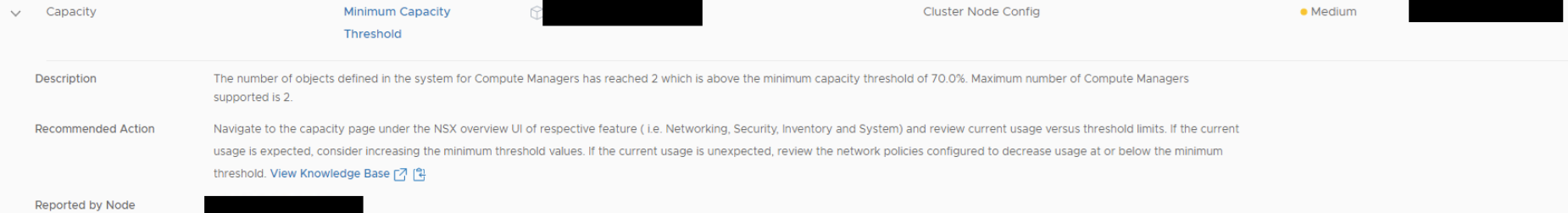

  • A capacity alarm with event type Minimum Capacity Threshold is reported in the NSX UI.
  • Error descriptions:
    • The number of objects defined in the system for Compute Managers has reached 2 which is above the minimum capacity threshold of 70.0%. Maximum number of Compute Managers supported is 2.

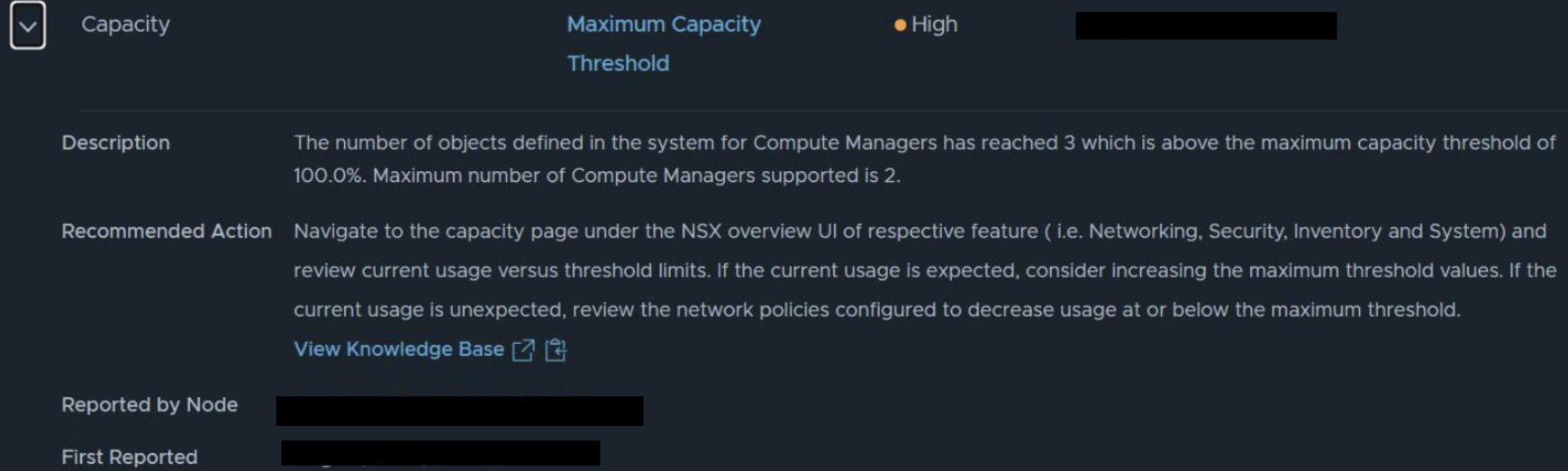

    • The number of objects defined in the system for Compute Managers has reached 3 which is above the maximum capacity threshold of 100.0%. Maximum number of Compute Managers supported is 2.
