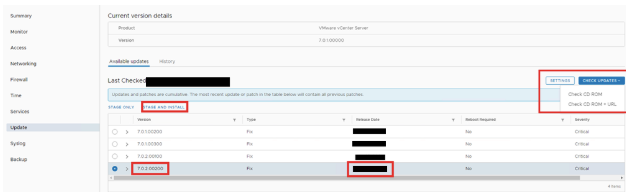

  2. Click on the Update tab.
  3. Ensure the update source is set to CD ROM + URL under the CHECK UPDATES menu.
  4. Select the target vCenter Server build. For more information about vCenter build numbers, refer Build numbers and versions of VMware vCenter Server.
  5. Click Stage and Install.

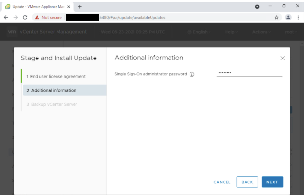

  8. Enter the vSphere SSO Administrator password when prompted.

  6. Click CHECK UPDATES and select Check CD ROM.
