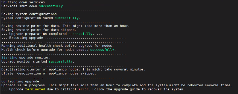

Symptoms:
  • Upgrading Orchestrator fails with:  VAMI exiting with error code: 1.
  • The /opt/vmware/var/log/vami/updatecli.log contains a package dependency error similar to:
