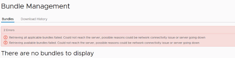

Symptoms:
Similar errors maybe observed in the SDDC Manager UI:
Similar errors are found in the lcm.log
