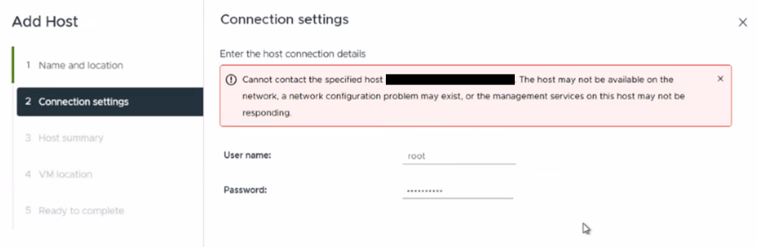

  4. While reconnecting/adding a host to vCenter, it fails with the following error:
    "Cannot contact the specified host (hostname.example.com). The host may not be available on the network, a network configuration problem may exist, or the management services on this host may not be responding."
