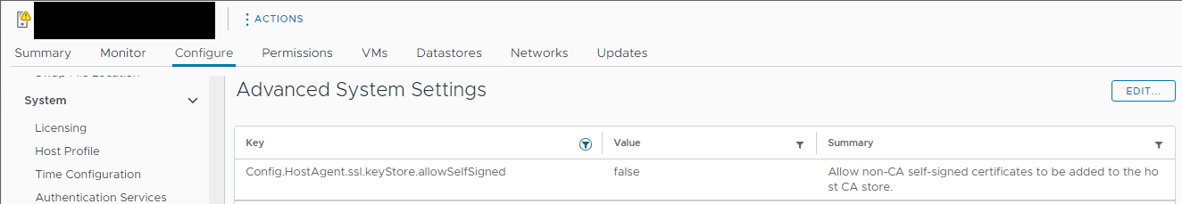

2. The ESXi host has parameter Config.HostAgent.ssl.keyStore.allowSelfSigned is set to false
3. The Storage/VASA Certificate presented to vCenter is incorrectly signed or missing Subject Alternate Name (SAN) and/or Common Name(CN).
NOTE: The default setting of Config.HostAgent.ssl.keyStore.allowSelfSigned is false

There are 2 important settings we need to discuss about that impacts the vVol PE, they are vpxd.certmgmt.mode in vCenter & Config.HostAgent.ssl.keyStore.allowSelfSigned in ESXi host.
Config.HostAgent.ssl.keyStore.allowSelfSigned 	False   You can only add CA (CRL Signed) self-signed certificates to the ESXi trust store, that is, certificates that have the CA bit set to true.
Config.HostAgent.ssl.keyStore.allowSelfSigned 	True     It allows an ESXi host to accept any certificate in the trust store. This option allows both non-CA & CA self-signed certificates.

  • Go to the ESXi host in vCenter > Advanced System Settings & change the parameter Config.HostAgent.ssl.keyStore.allowSelfSigned  to true/false based on the type of certificates. Please check the table above to understand what each option means.
