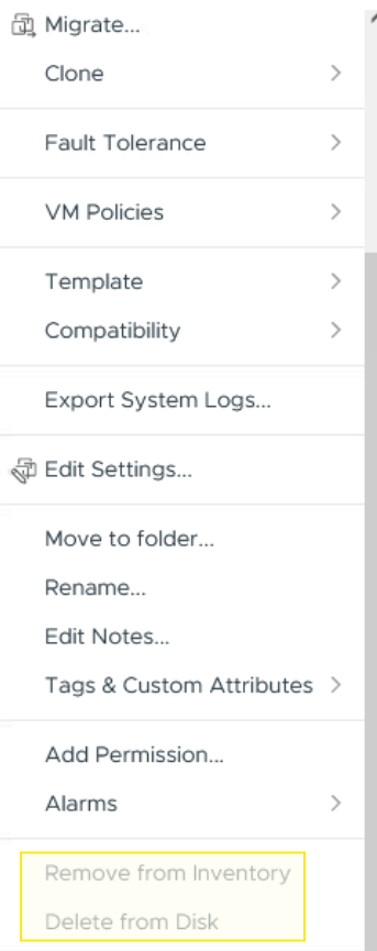

  • A virtual machine cannot be removed from the inventory.
  • The "Remove from Inventory" or "Delete from Disk" option is grayed out.
  • The virtual machine appears as "orphaned" or "inaccessible" in the vSphere Client.
