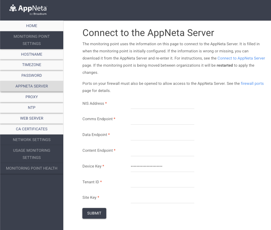

You can check the Web Admin, by clicking on:
Monitoring Point Settings ->  AppNeta Server
If only the Device Key appears populated, this is an indication that you need to attempt to Provision the appliance again, and in fact ALL values are likely missing.
