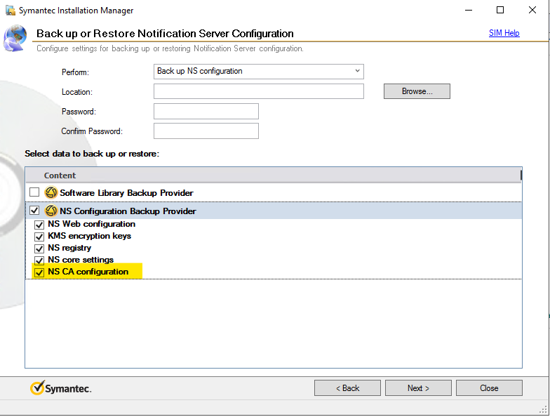

The Server CA and Agent certificates from the original SMP Server were not migrated properly.
In this particular instance, for the Symantec Management Agent and Internet Gateway to be able to validate the certificates in use, it is necessary to use the same root certificates (which for ITMS are the Server Ca and Agent CA certificates).
The following needs to be done in order to ensure the proper Server CA and Agent CA certificates are placed on the new SMP server for proper communication:
Windows Registry Editor Version 5.00
[HKEY_LOCAL_MACHINE\SOFTWARE\Altiris\eXpress\Notification Server\CA\Agent]
"Thumbprint"="E4C91063xxxxxxxxxxxxxxxxxxxxxxxAC2"
