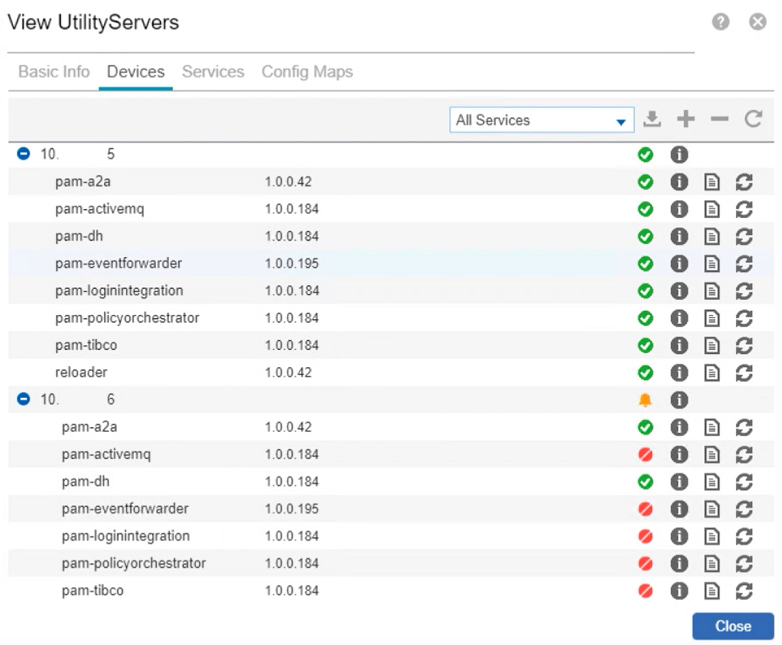

After the Utility Appliance was rebooted, only the pam-a2a and pam-dh services are started.
The stopped services have the same error saying "Failed to fetch activemq password."
Tomcat logs do show  <macaddr>EE:EE:EE:EE:EE:EE</macaddr>
Privileged Access Manager 4.0.x, 4.1.x with one or more Utility Appliances
