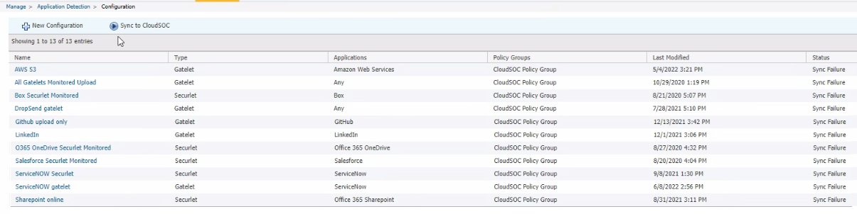

After one or more entries for Application Detection has been configured in the Enforce Server web console, the sync status in the list of configured applications shows "Sync Failure".

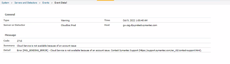

In this case, the Cloud Detection Server is configured correctly, but there is some issue on the CloudSOC CDS connection which is preventing successful sync with DLP.

  1. Return to DLP Enforce Console / Application Detectors - and click on "Sync to CloudSOC" again
  2. If this reset process was successful in approx 2 to 3 minutes you should see "Sync Successful" similar to screenshot below
