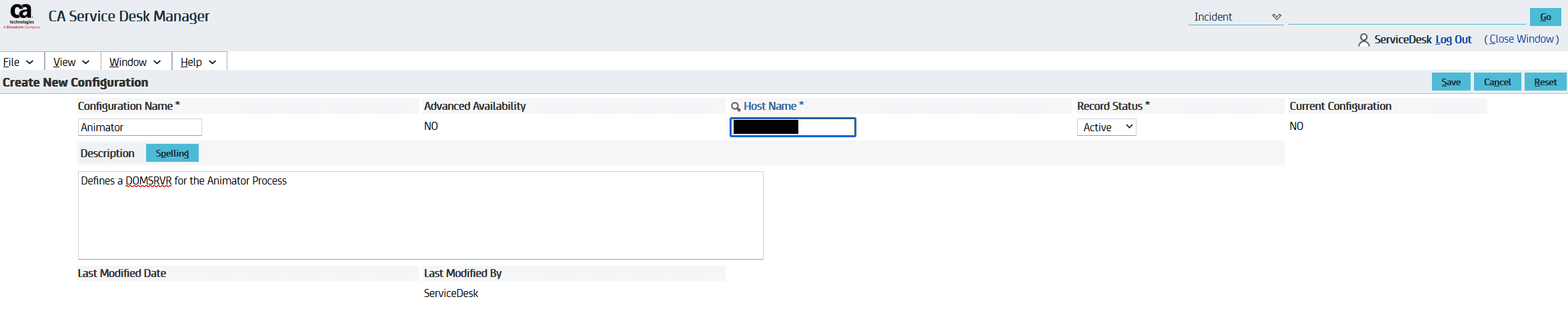

3. If running SDM with Primary server only, create a new configuration in SDM:

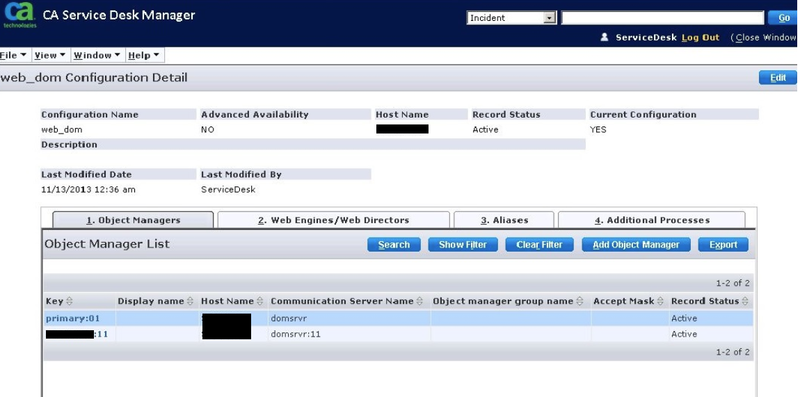

4. If running SDM with Primary and Secondary servers, edit the existing configuration.
In the example below, web_dom is the existing configuration on a Primary/Secondary installation:

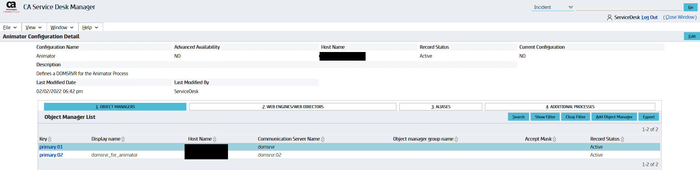

5. Create a new DOMSRVR process. In the example, it is named "domsrvr_for_animator".
Important: take note of the Communication Server Name. In the above example, it is named: domsrvr:02

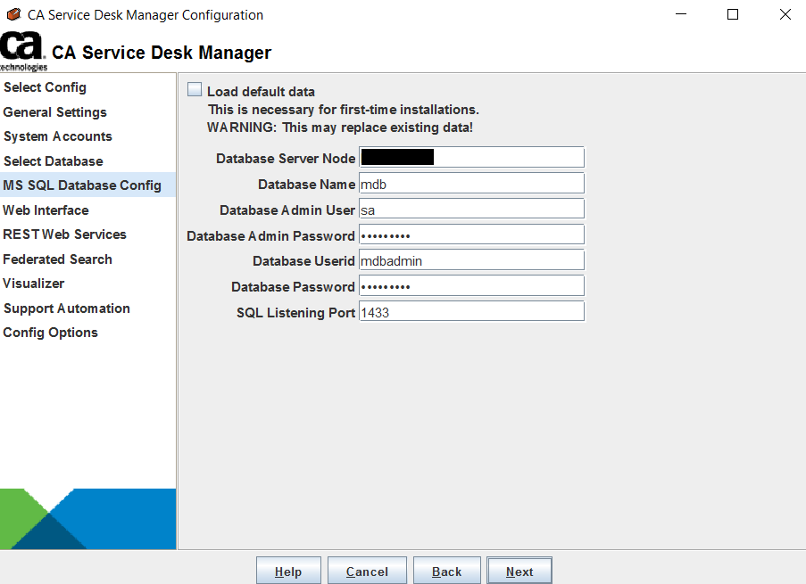

5. Run pdm_configure. Leave "Load default data" unchecked:
 For Config options, select the appropriate configuration and leave "Start SDM services" unchecked:
  • For the Primary and Secondary server installation, you should select the existing Configuration
  • For the Primary server only installation, you should select the new Configuration created

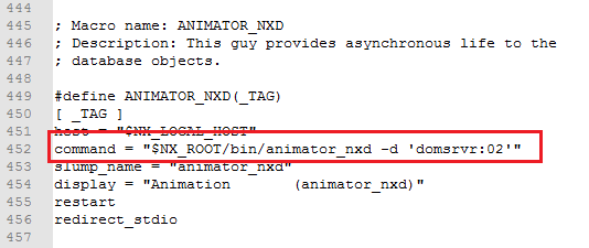

6. To configure Animator to the newly added dedicated DOMSRVR:
Locate the following two files under NX_ROOT\pdmconf
  pdm_startup.i
  pdm_startup.i.tpl
Open both files with a text editor and search for #define ANIMATOR_NXD(_TAG) and edit the command to:
Here domsrvr:02 is the name of the domsrvr created in step #4.

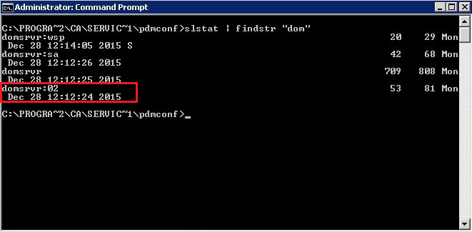

8.  To validate that the DOMSRVR process created is running, run the following command in a command prompt:
slstat | findstr "dom"
