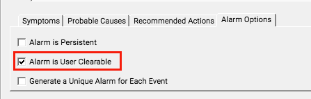

Existing alarms in OneClick cannot be cleared because at the time they were generated the "Alarm is User Clearable" field was not selected in Event Configuration Editor
CA Spectrum
Selecting the "Alarm is User Clearable" Field in Event Configuration Editor will only apply to new alarms that come into OneClick and not existing alarms.
The only way to clear these alarms will be to manually generate the event as specified in the Event Configuration Editor that clears the alarm.
