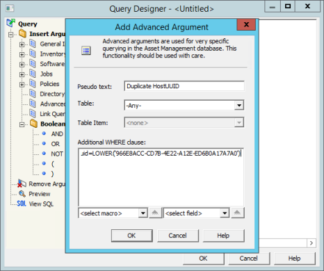

1- Create a custom query, to detect any computer currently registered with the known duplicate HostUUID:
- DSM Explorer --> Queries --> All Queries --> New.
- Choose "computers" as your target, and choose the "advanced argument" option from the query editor.
- Advanced argument details:
Pseudo Text: "Duplicate HostUUID"
Table: "-Any-"
Additional where clause: "select dis_hw_uuid from ca_discovered_hardware where host_uuid=UPPER('966E8ACC-CD7B-4E22-A12E-ED6B0A17A7A0') or host_uuid=LOWER('966E8ACC-CD7B-4E22-A12E-ED6B0A17A7A0')"
- Previewing the query result will validate it's entered into the query editor successfully. Only ONE computer should be returned, matching the HostUUID you specified.

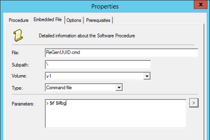

3- Create a Software Package for executing the following in a batch/command script:
@echo off
ccnfcmda -cmd DeleteParameter -ps itrm/rc/host/managed -pn convertedhostuid
ccnfcmda -cmd DeleteParameter -ps itrm/cfencrypt -pn LOCALID
ccnfcmda -cmd DeleteParamSection -ps itrm/rc/security/providers/winnt/users
reg delete HKLM\SOFTWARE\ComputerAssociates\hostUUID /f
reg delete HKLM\SOFTWARE\Wow6432Node\ComputerAssociates\hostUUID /f
taskkill /F /IM amagentsvc.exe /T
caf kill all
del /S /Q "%sdroot%\..\Agent\units\"
del /S /Q "%sdroot%\..\logs\"
caf start
exit /b 0
This script is designed to do the following:
- Remove the current HostUUID from the agent comstore.
- Remove the current HostUUID from the registry.
- Kill any AM agent execution, that may already be in-progress.
- Kill the CAF service.
- Remove the units folder, which will force the agent to generate a new/completed inventory.
- Remove the existing agent trace logs.
- Restart the CAF service.
Here's an example of the procedure properties in Software Delivery:
As the script is designed to kill the CAF service, and trigger the HostUUID to be regenerated, it's advisable to choose, "Run job off-line from the scalability servers", under the procedure options:

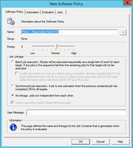

5- Create a new Software-based policy to automate the software package:
- DSM Explorer --> Policies --> Software Based: New Software Policy
- Choose the software package created from step 3.
- Choose the computer group created from step 2.

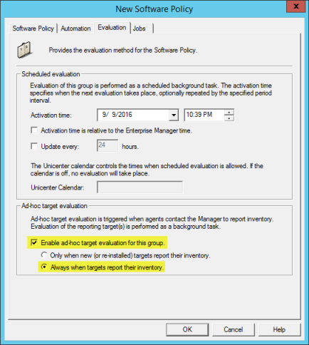

- Give the software policy a meaningful name, and ensure the option for "Open the advanced software policy settings dialog when the finish button is pressed."...
- Ensure the highest degree of automation is set
- Normally, it is NEVER recommended to use ad-hoc policy evaluations, as system performance can be reduced drastically by constant evaluations running in the background. However, due to competing computer registrations with the same HostUUID, we need the Software-based policy to react quickly, and setup a job to the target computer:
- Once again, ensure the "Run job off-line from the scalability servers" option is selected, under the procedure options for the job:
