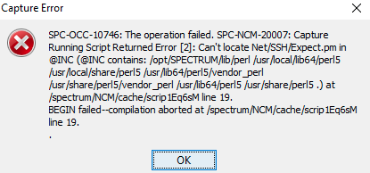

My custom Network Configuration Manager (NCM) SSH-based Perl Scripts that work on Spectrum which is running on Windows, fail with the following error when Spectrum is migrated to Linux (RHEL) platform.
SPC-OCC-1074: The operation failed. SPC-NCM-20007: Capture Running Script Returned Error [2]: Can't locate Net/SSH/Expect.pm in @INC ...
Although I have confirmed Perl exists in the RHEL platform, I have installed Net::SSH Perl module and I have enabled Use Custom Perl and set up Custom Perl Directory correctly in the Configuration Manager -> Information tab -> Perl Configuration subview.
SpectroSERVER running on RHEL 7 or 8
Net:SSH:Expect Perl Module hasn't been installed.

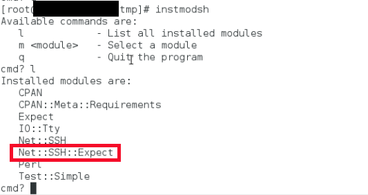

Login to the SpectroSERVER machine and run 'instmodsh' command and type 'l' to list Perl modules that have been installed and check if you have Net:SSH:Expect module.
If you don't have Net::SSH::Expect module then run 'cpan' utility and on the cpan prompt run 'install Net::SSH::Expect' to install the required Perl Module.

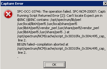

Note that in the above example, the missing module mentioned in the error message is "Expect.pm". There may be different missing modules mentions in different error messages, so be sure to note exactly which module is missing in order to install the right one. For example, you may see an error on "OpenSSH.pm"
SPC-OCC-1074: The operation failed. SPC-NCM-20007: Capture Running Script Returned Error [2]: Can't locate OpenSSH.pm
In which case, the command to install this module in cpan would be
cpan[1]> install Net::OpenSSH

5. Now quit, and run instmodsh
cpan[4]> quit
Terminal does not support GetHistory.
Lockfile removed.
# instmodsh
Available commands are:
   l            - List all installed modules
   m <module>   - Select a module
   q            - Quit the program
cmd? l
Installed modules are:
   CPAN
   CPAN::Meta::Requirements
   Expect
   IO::Tty
   Local::Works::Fine
   Net::SSH::Expect
   Perl
   Test::Simple
   version
cmd? q
