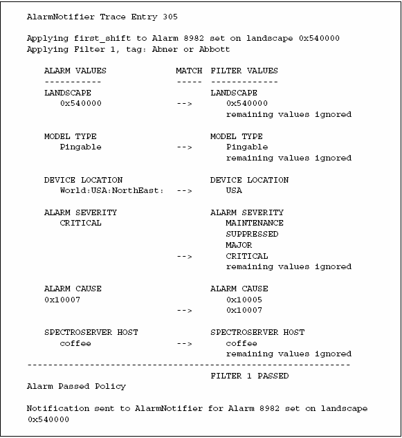

The Detailed Trace File
A detailed trace file includes entries for alarms that meet and that do not meet the criteria of a policy. An alarm entry includes the alarm attribute values, which that are compared to the filter parameter values. An arrow symbol under MATCH between ALARM VALUES and FILTER VALUES indicates a match. The arrow is absent if the values do not match.
The following is an example of a trace file that indicates that an alarm passed a policy:
Please reference the "Tracing Policies" section of the documentation for more details:
In the output above the Alarm ID that is given in the debug  (8982) is the Integer Alarm ID.
