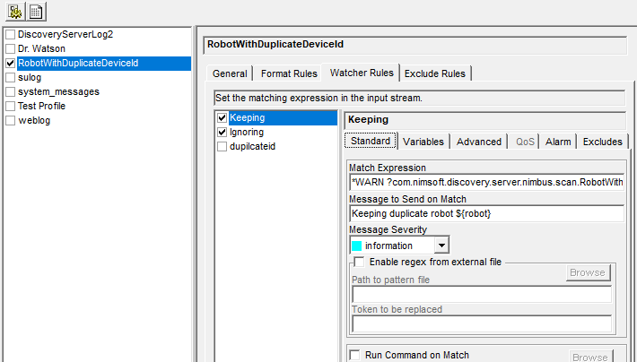

Logmon setup
From Infrastructure Manager, access your archive and download logmon if it is not already.
Deploy logmon to your Primary hub
Open the logmon configuration UI
Right Click in the left pane and click New
Give the profile a name like "RobotWithDuplicateDeviceId"
Click the check box next to the profile name to activate it.
On the General tab, browse to the location of your discovery_server.log.
In Windows the default location is C:\Program Files (x86)\Nimsoft\probes\service\discovery_server
In Linux the default location is /opt/nimsoft/probes/service/discovery_server
Uncheck 'Generate Quality of Service'
Click the Watcher Rules tab
Right-click in the left pane of this tab and choose New
Give the watcher a name of "Keeping"
Click the checkbox next to the Watcher name to activate it.
On the Standard tab,
Match Expression: *WARN ?com.nimsoft.discovery.server.nimbus.scan.RobotWithDuplicateDeviceIdPruner - Keeping robot*
Message to Send on Match: Keeping duplicate robot ${robot}

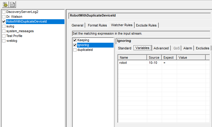

On the Variables tab
Right-click in the list section and choose New
Source FROM Position
Select Column and enter 10 for the value
Source TO Position
Select To Column and enter 10 for the value
Click OK

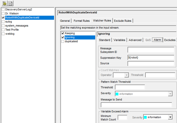

On the Alarm tab
Suppression Key: ${robot}
Source TO Position
Click OK
On the Alarm tab
Click OK on the probe GUI to save and activate the new profile.
