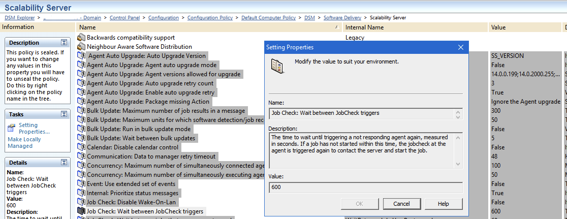

The solution is to increase the value of the parameter "Jobcheck: Wait between JobCheck triggers" (WaitBetweenJobCheckTriggs) in Default Computer Policy:
  1. In DSM Explorer drill down to Control Panel->Configuration->Configuration Policy.
  2. Unseal the Default Computer Policy.
  3. Under DSM->Software Delivery->Scalability Server, change the value of parameter "Jobcheck: Wait between JobCheck triggers" from 600 (10 minutes) to 10800 (3 hours).
  4. Seal the policy.
  5. Wait for some minutes for the policy to be applied on the DOMAIN.
