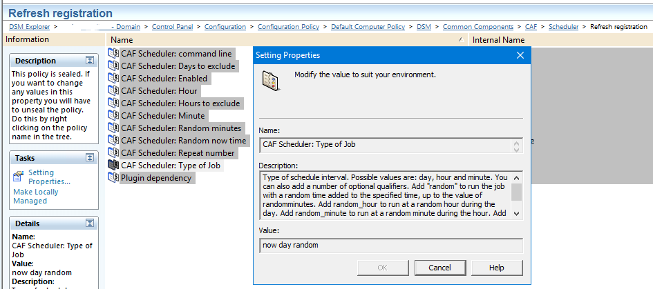

AM Agent and SD Agent are automatically started by Scheduled job Registration refresh scheduled job (caf register).
The type of this job is: now day random.
This job is executed at the startup of CAF service because it is of type "now".
Remove the "now" keyword from Caf Scheduler: Type of job configuration policy under:
DSM/common components/CAF/Scheduler/Refresh Registration
