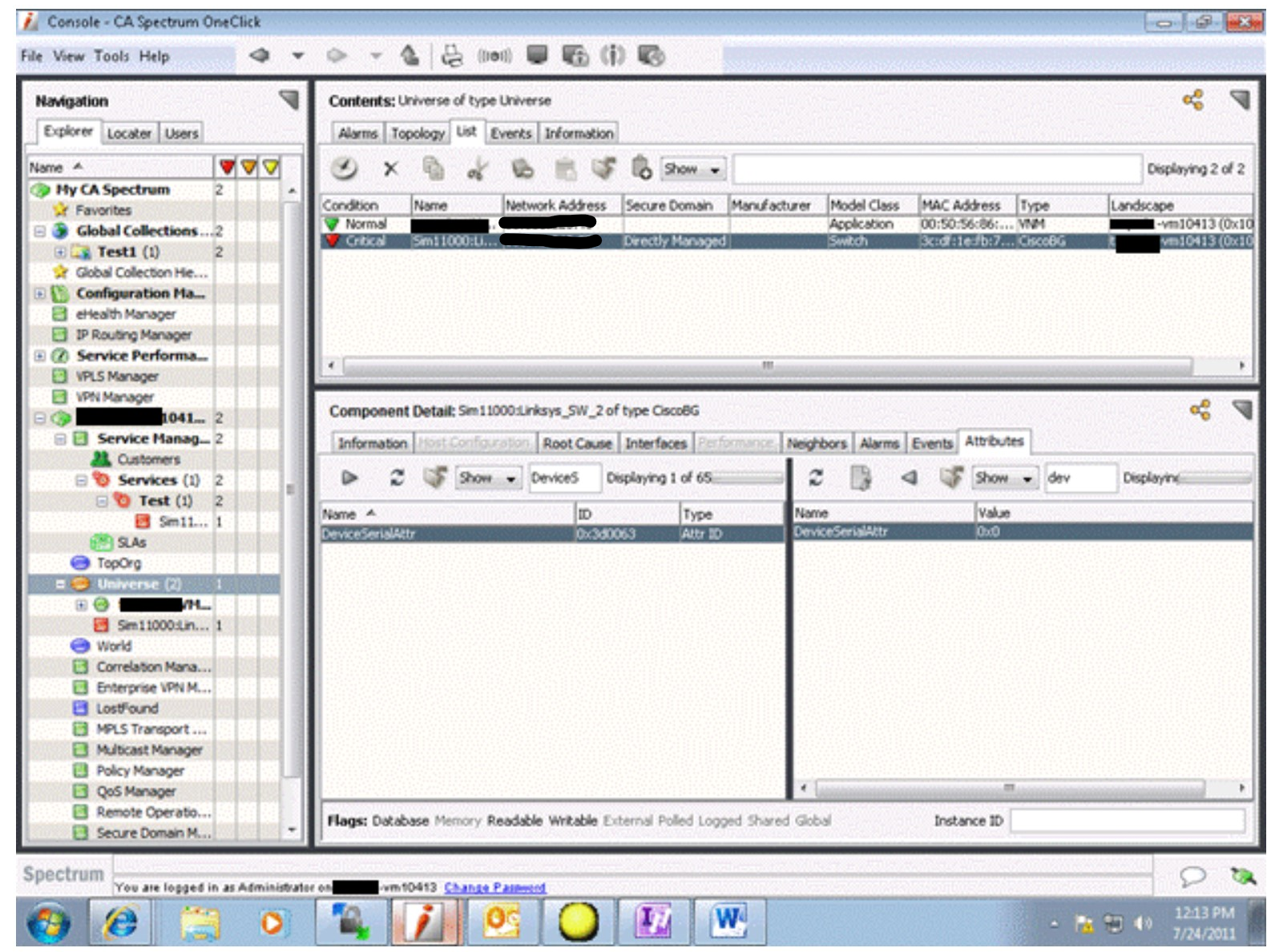

  5. Filter for the attribute DeviceSerialAttr on the same model.
  6. Drag the DeviceSerialAttr towards the right panel
  7. Double click on the DeviceSerialAttr and enter the attribute id of the custom serial number attribute into the value of DeviceSerialAttr attribute.
By doing this the value of the custom serial number attribute is passed on to the default serial number attribute.
