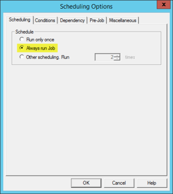

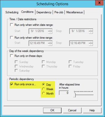

DSM Explorer -> Control Panel -> Configuration -> Collect Tasks -> All Collect Tasks
The general recommendation is to reduce the "Inventory Configuration" (hardware inventory configuration) to once per day scheduling.  To set the scheduling, simply right click on the task, and select, "Scheduling..."
Note 1: Depending on realistic business requirements and environment size, it may be favorable to choose "Run only once a week" for the inventory configuration.
Note 2: By default, the "Software Inventory Configuration" is already set to once per day.  It is wise to double check the default has not been changed.  Also per business requirements and environment size, it may be favorable to choose "Run only once a week" for this scan, as well.
Note 3: If the domain manager is linked to an enterprise manager, as in the first screenshot, you will see two sets for each built-in task.  As the agent will consider scheduling settings from both the domain and enterprise managers, ensure the settings are mirrored on both managers.  To change the values for the replicated/enterprise created tasks, you must use DSM Explorer on the enterprise manager.  The configuration seen on the domain manager is actually replicated from the enterprise manager.
Note 4: If you have additional custom inventory tasks, ask yourself how often you need the agent to report this data?  The answer should hopefully not be more often than once per day, and in most cases, once per week or month may be sufficient.  Ask yourself how often you realistically need this data reported by the agents, and what may be the trade-offs for requesting inventory too often.
