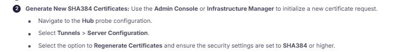

Documentation states to "Ensure settings are set "SHA384" but I don't see any option

In hub GUI There is no SHA384 setting to change.
Hubs 23.4.7 and later sign every certificate it generates with SHA384 and the GUI offers no choice.
You get a SHA384 certificate by regenerating it:
  1. Open the hub configuration, then Tunnels > Server Configuration.
  2. Leave the Security Settings as they are. They only control the TLS cipher.
  3. Regenerate the certificates with the CA and Server buttons. Issue client certificates with New
