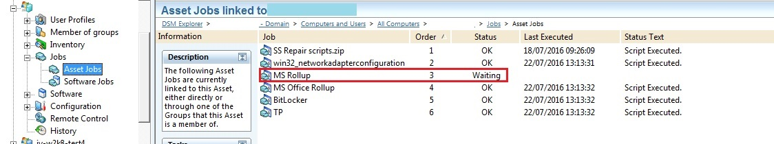

An Asset job remains in status Waiting for a lot of computers. It is not executed by AM Agent.
Others AM jobs and collect tasks are correctly executed by AM Agent

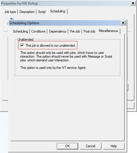

This problem could occur if option "This job is allowed to run unattended" is not checked in Scheduling Options - Miscellaneous tab of AM Job properties.
1- In ITCM Explorer, right click on the AM job and select properties in popup menu.
2- Click on Scheduling tab and click on button "Set Scheduling...".
3- Click on Miscellaneous tab and check the option "This job is allowed to run unattended".
4- Click OK buttons to validate the modifications.
5- Wait that Engine executes again the Scalability Server Collect job in order to update the job file with new properties on the Sector.
