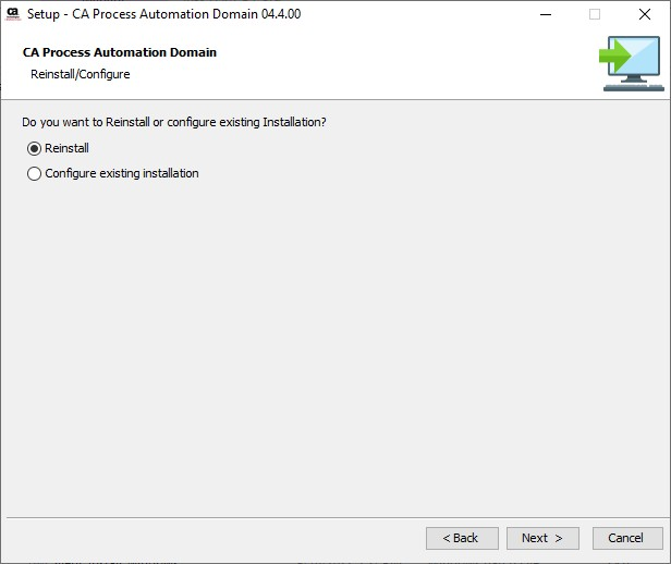

  6. Continue to follow the prompts, which will include the license agreement, the location of the Java/JDK Home directory
  7. You will see a dialog box that shows this.  Choose "Reinstall" and continue to follow the prompts
