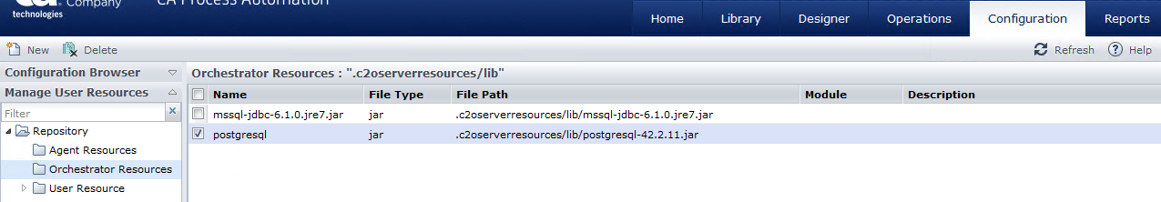

The Postgres JDBC driver was not deployed correctly to the orchestrator resources
First deploy the postgres JDBC Driver into the Orchestrator Resources on the Configuration Tab:
Which will place the file in the \CA\PAM\server\c2o\.c2orepository\.c2oserverresources\lib\ directory:
Specific directions on adding Orchestrator Resources can be found in the Process Automation Orchestrator Resources documentation.

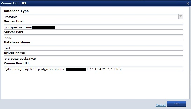

Then within your Process Definition:
1. Select Postgres in Connection Wizard.
2. Fill up the variables for Driver with the following:
Process.driver = “org.postgresql.Driver”
3. Modified the connection string generated by the wizard with this:
“jdbc:postgresql://”+ Process.host + “:” + Process.port+ “/” + Process.db”
NOTE: When ‘Postgres’ is selected in the Connection Wizard, by default the URL is generated with the following: “jdbc:”+ null+”://” .  This needs to be changed to “jdbc:postgresql://”.
