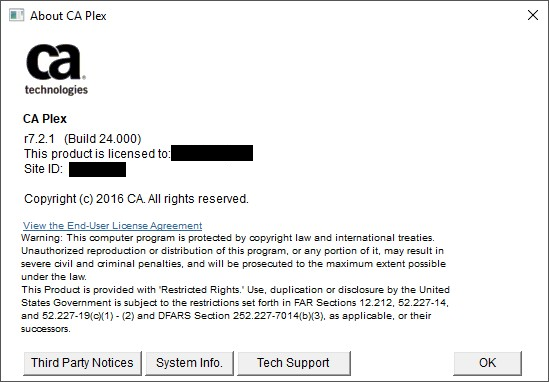

Go into the CA Plex IDE, then choose the Help -> About CA plex menu option.
You will see the PTF build level that is in place, which indicates the Cumulative Patch that has been installed.
In the example below, the version is 7.2.1 and no additional PTFs, indicating it is a GA Build with no further cumulative updates
