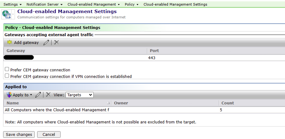

The Cloud-enabled Management Settings policy was checked and 'Prefer CEM gateway connection' options are not checked/enabled:
If the CEM connected machine on LAN is removed from the CEM policy, it then switches to normal LAN/direct connection without issues
