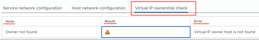

Q: What does the 'iSCSI target service health check - Virtual IP ownership check' do?
It checks if the iSCSI target service virtual IP ownership has mistake or not.
  • The column 'Issue' indicates the virtual IP ownership issue detected.
  • The column 'Result' indicates the error level (warning/error).
  • The column 'Error' indicates the detail information about detected issue.
Note: It is expected that if no warning state reported in the check result.
Q: What does it mean when it is in a warning state?
The detected issue and it indicate error can refer to the following table.
Issue Error indicated
Owner not found Virtual IP owner host is not found
Virtual IP not bound Virtual IP address is not set to the VMkernel adapter on the owner host
Multiple owner detected Virtual IP is assigned to multiple owner hosts, the invalid owner host name will be listed
In virtual IP ownership check, when the vSAN iSCSI target service virtual IP is enabled, but the virtual IP is not assigned to any host, then the health check will report issue 'Owner not found'. In this case, the virtual IP cannot work as expected.
In virtual IP ownership check, when the backend detects No IP on the iSCSI virtual IP used vmknic on some host(s), then the health check will report issue 'virtual IP not bound'.
In virtual IP ownership check, when the backend detects the virtual IP is assigned to multiple hosts, then the health check will report issue 'Multiple owner detected', with the host name which should not be the owner.
