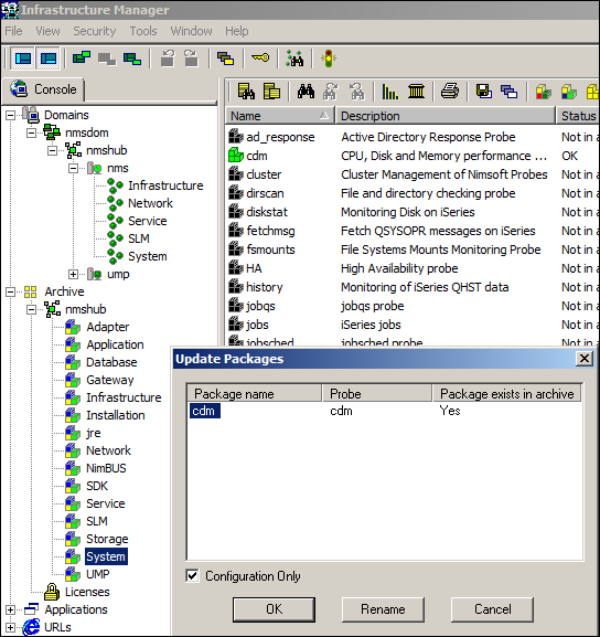

Follow these steps:
1.  Extract the configuration file from a deployed probe by first dragging and dropping the probe into the archive and choosing configuration only when prompted.

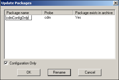

3.  Click on rename to provide a new package name so that the operation does not replace the original probe package.

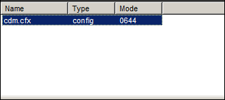

4.  Double click on the new config only probe in the archive and note the cdm.cfx configuration file contained therein as shown here:
5,  Right click on cdm.cfx and choose Edit File... from the menu.
6.  Edit the file based on the following configuration file information:
