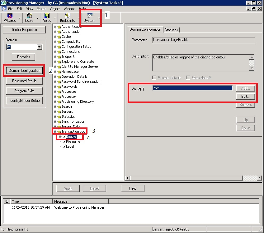

Provisioning Server
The provisioning server log level controls several different logs including the etatrans, etanotify, sa and satrans logs. The level is adjusted in the Provisioning Manager GUI. The logs are enabled by default, the enable/disable option is located under System > Domain Configuration > Transaction Log > Enable
The change in log level will not take effect until the next time the configuration is re-read (default is every 600 seconds but that can also be configured within the Domain Configuration settings) or until the Provisioning Server service is restarted.

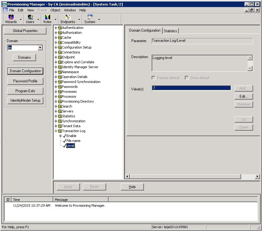

The level of logging saved in etatrans.log can be adjusted in Provisioning Manager under System > Domain Configuration > Transaction Log > Level.
Below are the log levels and their descriptions.
  • 0: No trans logging
  • 1: Log external/child errors
  • 2: Log external operations
  • 3: Log child operations
  • 4: Log informative messages
  • 5: Log DSA (Directory Service Agent) errors
  • 6: Log DSA operations
  • 7: Log search operations
For Broadcom Support debugging purposes logs should be set to level 7. Logs on lower levels are often unhelpful in troubleshooting and determining the root cause of an issue.

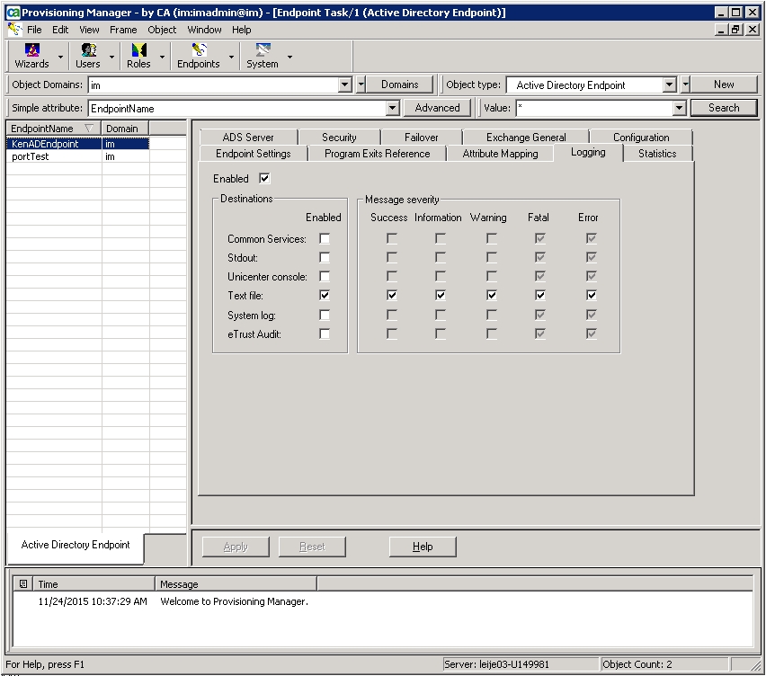

Endpoint logs (Active Directory and others)
Endpoint logs can be valuable when troubleshooting a specific endpoint issue. These logs are not enabled by default and must be enabled through the Provisioning Manager GUI.
To enable the logs:
  1. Go to Endpoints > xxxx Endpoint > [your specific endpoint] > Logging tab.
  2. Check the enabled box and all of the boxes next to Text File.  This will enable endpoint logging into the file saDDMMYY.log.
In the example below we are showing an Active Directory Endpoint logging tab, however, these steps are true for any other endpoint type too:
If the CCS is located on the Provisioning Server, the log files are located under:
\CA\Identity Manager\Provisioning Server\logs\saDDMMYY.log.
Active Directory Endpoints have additional endpoint-specific log files which are located under:
\CA\Identity Manager\Provisioning Server\logs\ADS\.
If the connector server is a standalone installation the log files are located under:
\CA\Identity Manager\Connector Server\ccs\logs\ads.
