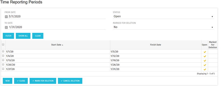

Check Time Reporting Periods
  1. Check to make sure there are open timesheet periods in the system in Administration > Project Management > Time Reporting Periods.
  2. Check to make sure that the Time Reporting Period records have a 'last_updated_date' value that is recognized by the Load DWH job.  If not, this can be remedied by making a change to the periods through the application, then reverting back

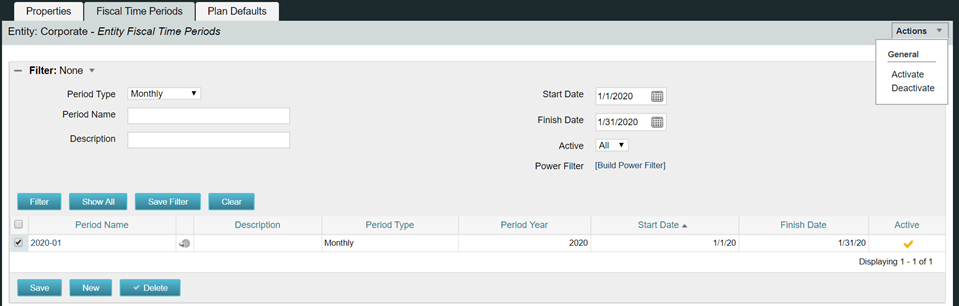

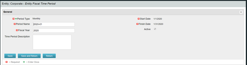

Check Fiscal Time Periods
Make sure Fiscal Time Periods that cover the entire period are created and active. To check this, go to Administration > Finance > Setup > Entity > Fiscal Time Periods > Monthly periods.
  1. If they don't exist, create them
  2. Next, ensure the fiscal time period created is activated by selecting and using action > activate
