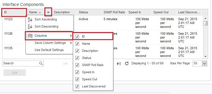

3. In the Interface Components, click the drop-down icon in any of columns to add the ID column as below:
4. Take note of the ID of the interface we want to troubleshoot from in the step 3 above;
