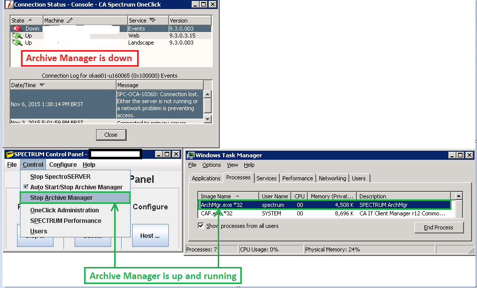

Recently the SpectroSERVER and OneClick server have been restarted.
After starting in Spectrum OneClick console, events are not shown, with error as "Achieve Manager is not available."
In spectrum control panel, Archive Manager is in start state.
Note: If you have Secondary Archive Manager configured the status may show Switched.

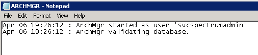

The Archive Manager is validating the DDMdb database.
When reviewing the $SPECROOT/SS/DDM/ARCHMGR.OUT file it contains just a couple of lines:
Apr 30 09:35:06 : ArchMgr started as user 'user'
Apr 30 09:35:06 : ArchMgr validating database.

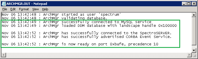

Once the validation is completed successfully, you will be able to access the Archive Manager database.
