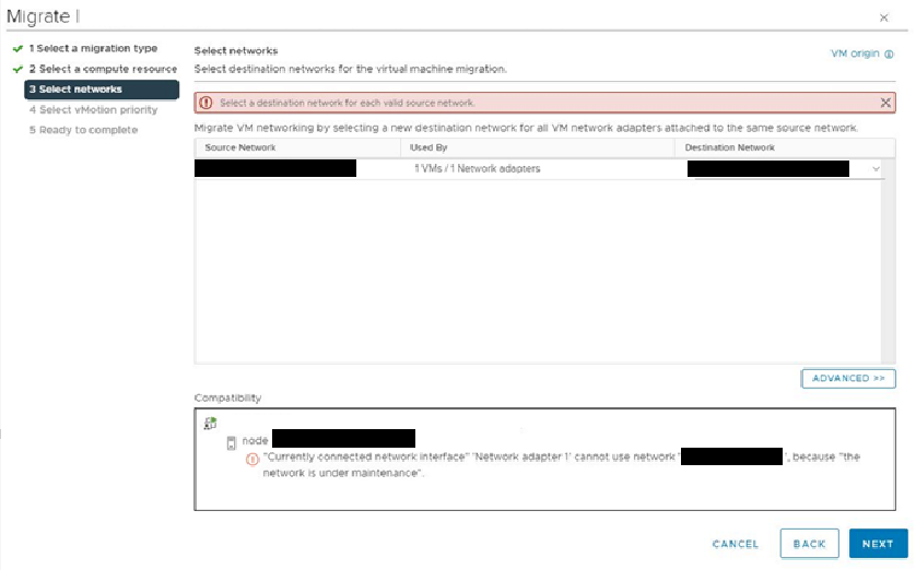

  • Manual VM vMotion setup during step 3, "Select networks", shows a node compatibility issue when the source host is affected, that states:
    Currently connected network interface" 'Network adapter #' cannot use network '<host switch>', because "the network is under maintenance".
  • For migrations to an affected host, compatibility Issues state that a network interface is not accessible and "the network is under maintenance" as well.

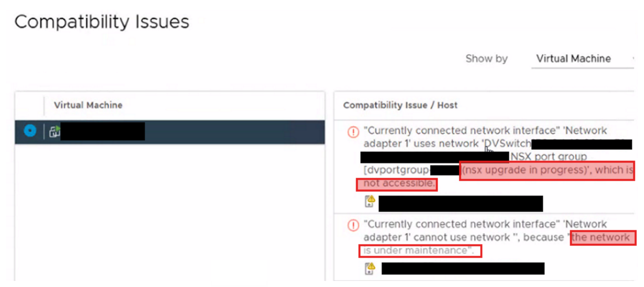

  • vMotion of the virtual machine between the ESXi Hosts results in a compatibility warning as seen below:
    Currently connected network interface" 'Network adapter 1' uses network "DVSwitch[(#########################] NSX port group [dvportgroup-##### ] (nsx upgrade in progress)'. which is not accessible.
    Currently connected network interface" 'Network adapter 1' cannot use network", because "the network is under maintenance"

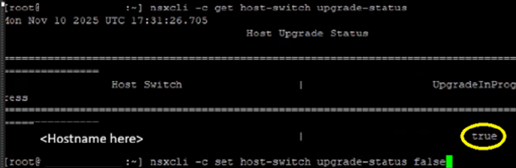

  2. Verify the issue by running the following command on the ESXi host shell:
    nsxcli -c get host-switch upgrade-status
  3. Clear the upgrade status flag on the host:
    nsxcli -c set host-switch upgrade-status false
  4. Repeat the steps above for any other hosts in the cluster showing similar symptoms.
  5. If these steps are being taken to resolve an NSX upgrade failure, then complete the above steps followed by placing the host in Maintenance mode (migrate VMs off the host now that it is possible) and reboot the host.
