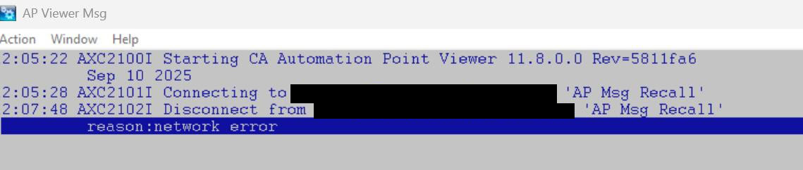

Have configured Automation Point (AP) to use Remote Viewer with no security to test but cannot connect to the Remote Manager using a remote client. Receive message:
AXC2110E Remote Manager on hostname is not running

A second occurrence of this type of problem has been reported for only one AP Server SERVER5. The user seeing various problems using Remote Viewer to SERVER5 from a remote client. Using Remote Viewer on SERVER5 itself does not have any problem.
The "CA-AP Remote Manager" service on SERVER5 is running on default port 5500.
Remote Viewer on another AP Server to SERVER5 shows "AXC2110E Remote Manager on hostname is not running"
Running 'telnet SERVER5 5500' on that other server also failed indicating firewall problem per above.
Remote Viewer on laptop to SERVER5 shows connect and then disconnect 140 seconds later.
No 2nd dialog 'AP Msg Recall' is opened after the connect.

Thus although the Remote Viewer on the laptop is showing as connected it does not seem to be getting as far as the Remote Manager itself and it must just be connected at some base TCP/IP socket layer. That lines up with not seeing the 2nd dialog for 'AP Msg Recall' being opened and the 140 seconds before disconnect is probably a socket timeout at the laptop end because it is not getting the expected response.
2. Laptop AP Logs
The apview.out and older apview.out.* logs show a "Lost Connection -113" error as well as the "reason:network error" seen in the Remote Viewer:
12:29:40.953 S5 P59556 T60532 C=NA Task=21  WINDOW MANAGER: (rem_open,1,I)   AXC2101I Connecting to server5.www.xxx.yyy.zzz 'AP Msg Recall'
12:29:40.959 S5 P59556 T60532 C=NA Task=21  REM_server5.www.x.:AP Msg Rec: (ipq_open_tcp,2000,E)   IpqInit: Unable to load WinSock DLL 'ca2_32.dll'; rc:126
12:32:02.241 S5 P59556 T21592 C=NA Task=16  REM_server5.www.x.:AP Msg Rec: (snd,103,5000,W)   Lost Connection -113
12:32:02.241 S5 P59556 T21592 C=NA Task=16  REM_server5.www.x.:AP Msg Rec: (snd,103,1,I)   AXC2102I Disconnect from server5.www.xxx.yyy.zzz 'AP Msg Recall' reason:network error
12:40:59.127 S5 P59556 T62884 C=NA Task=14  WINDOW MANAGER: (rem_open,5,I)   Connect server5.www.xxx.yyy.zzz 'AP Msg Recall'
12:40:59.127 S5 P59556 T62884 C=NA Task=14  WINDOW MANAGER: (rem_open,1,I)   AXC2101I Connecting to server5.www.xxx.yyy.zzz 'AP Msg Recall'
12:43:18.089 S5 P59556 T63236 C=NA Task=7   REM_server5.www.x.:AP Msg Rec: (snd,103,5000,W)   Lost Connection -113
12:43:18.089 S5 P59556 T63236 C=NA Task=7   REM_server5.www.x.:AP Msg Rec: (snd,103,1,I)   AXC2102I Disconnect from server5.www.xxx.yyy.zzz 'AP Msg Recall' reason:network error
