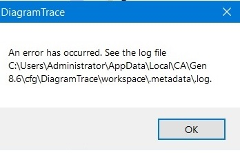

However, after the installation of 8.63 Consolidation PTF WKS86300 the DTU attempted startup fails and a DiagramTrace dialog box appears with message:
An error has occurred. See the log file C:\Users\UserID\AppData\Local\CA\Gen 8.6\cfg\DiagramTrace\workspace\.metadata\.log

Those updates mean the new files are incompatible with the existing DTU cache located under its temporary work directory "C:\Users\USERID\AppData\Local\CA\Gen 8.6\cfg\DiagramTrace".
Rename the temporary work directory "C:\Users\USERID\AppData\Local\CA\Gen 8.6\cfg\DiagramTrace" to clear the current DTU cache and resolve the problem.
