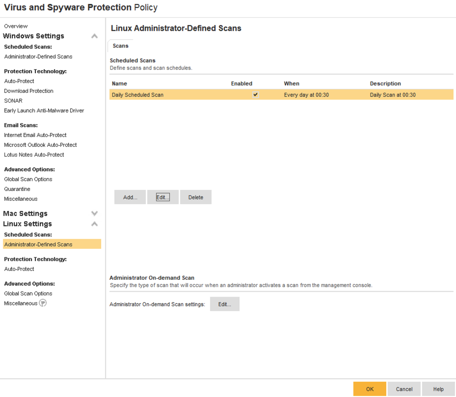

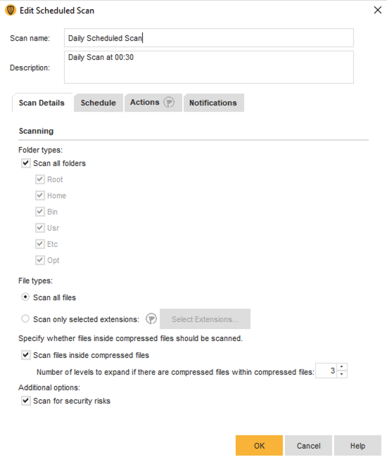

If an upgrade is not feasible at this time, you can mitigate the issue by disabling 'Missed Scheduled Scans' within the Schedule tab of the Administrator-Defined Scans settings.
The default setting is selected on for 24 hours.  De-selecting this will keep the agent from running a scan after restart or reboot of the server.
Select the Schedule Tab;
Uncheck the retry option.
