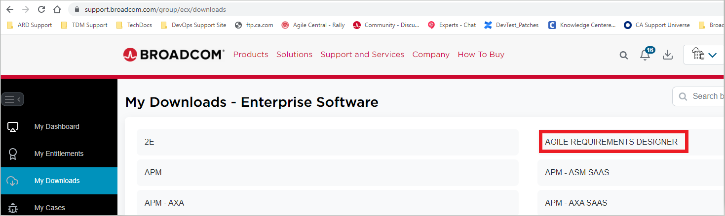

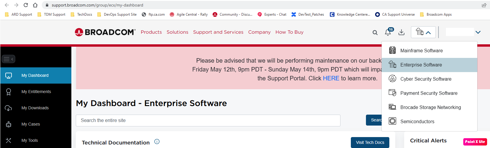

    • Log into https://support.broadcom.com
    • Select Enterprise Software
    • Select "My Downloads" > "Agile Requirements Designer"

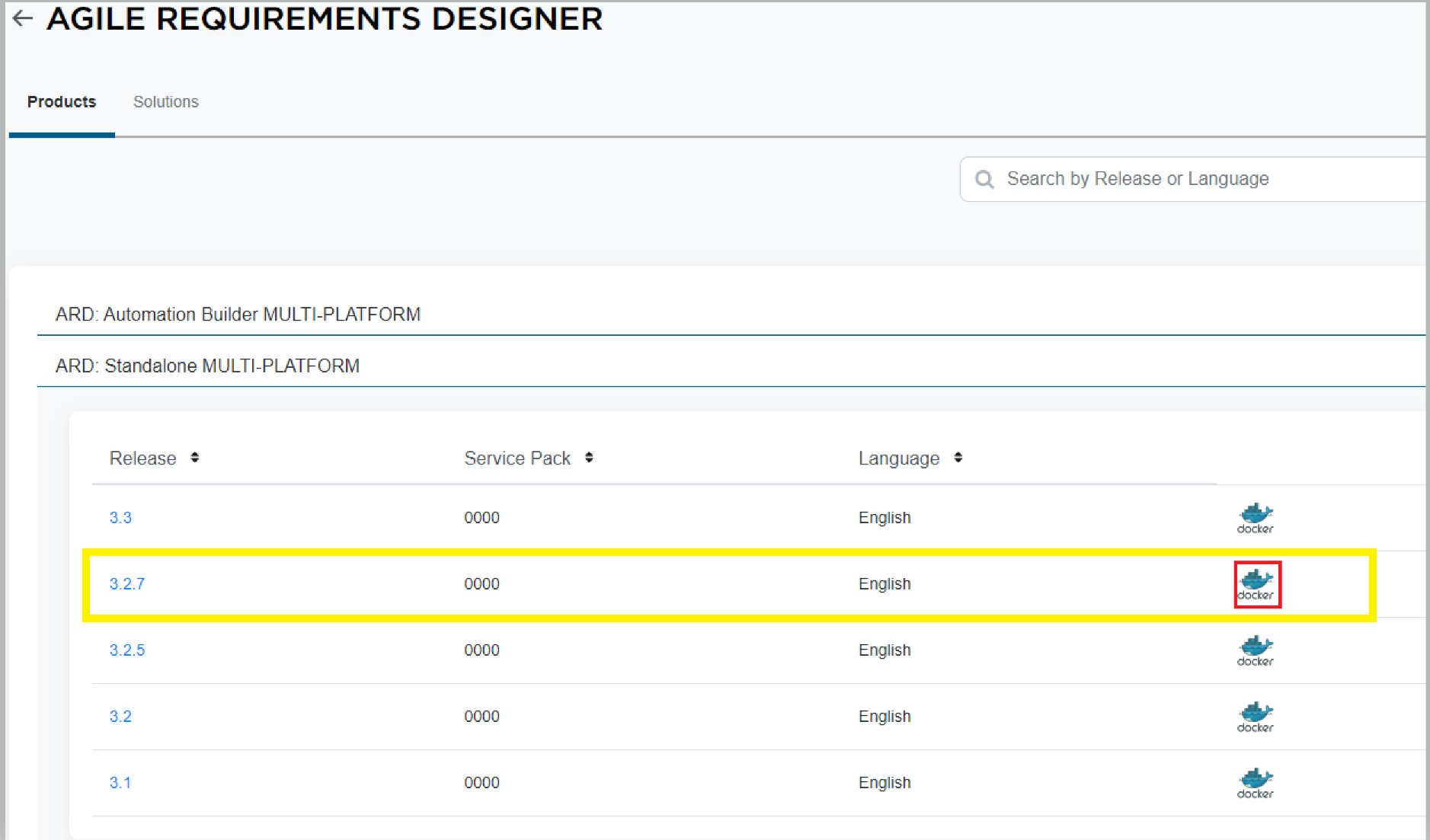

    • Expand the Product SKU that your site has access to. Your choices could be different from the example used.
    • Click the Docker icon that correlates to ARD 3.2.7 release.
    • Copy the provided custom commands and paste them into a terminal window. Run the custom commands to initialize temporary local environment variables:
