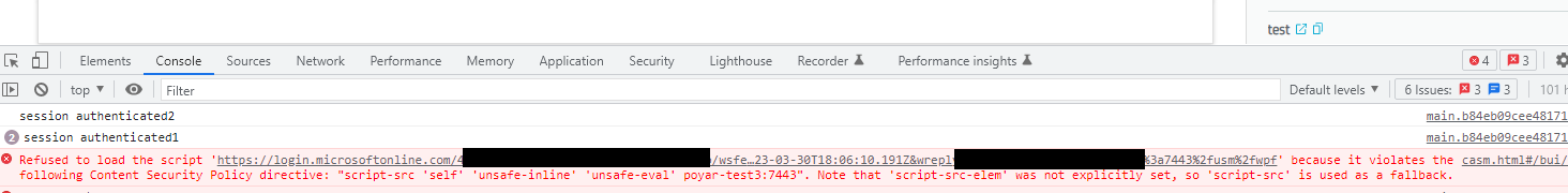

When Service Point is trying to load Catalog data, the following appears in the web browser Console tab:
Refused to load the script 'https://login.microsoftonline.com/<ID>/wsfed?wa=wsignin1.0&wtrealm=https%3a%2f%2f<hostname>%3a7443%2fusm%2fwpf&wctx=%2fusm%2fwpf%3fNode%3dicguinode.buiticketsstatus%26b2b%3djson-html%26eiamArtifact%3dUserSession%3bVersion-1.0%3bdd623ec33cb797fc9d63c0b568f40b99-64257129-a79aa20-4b%26callback%3dng_jsonp_callback_1&id=passive&wct=2023-03-30T18:06:15.289Z&wreply=https%3a%2f%2fXXXXXXX%3a7443%2fusm%2fwpf' because it violates the following Content Security Policy directive: "script-src 'self' 'unsafe-inline' 'unsafe-eval' ". Note that 'script-src-elem' was not explicitly set, so 'script-src' is used as a fallback.
