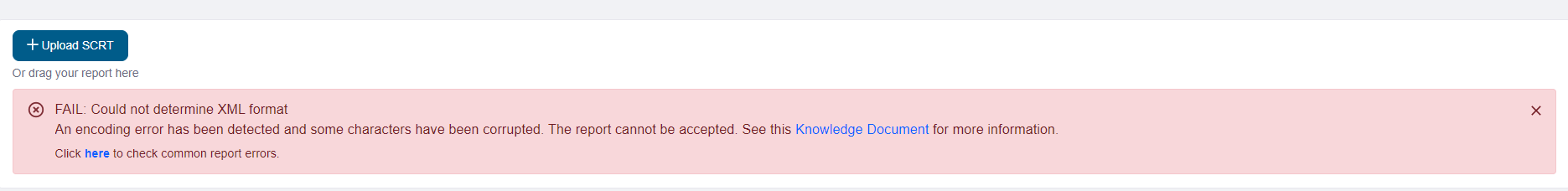

I am getting the following when sending a SCRT text file to your site please advise.
Reasons for report failure:
FAIL: Could not determine XML format
An encoding error has been detected and some characters have been corrupted.
