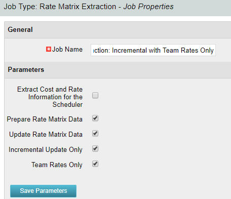

  • Incremental Update Only - Specifies rates extraction only for currently updated projects. Running the job takes less time when compared with a full run.

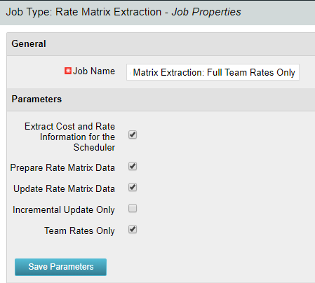

  • Team Rates Only - If this option is NOT selected, then the job populates all the rates pertaining to the team and task assignments. If this option is selected, the job populates the rates related ONLY to the team. It does not extract task assignment rates.
Examples of how to select the parameters:

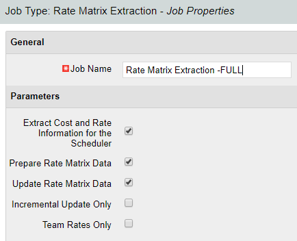

Full RME
Full RME with TEAM RATES ONLY

Incremental with Team Rates Only
