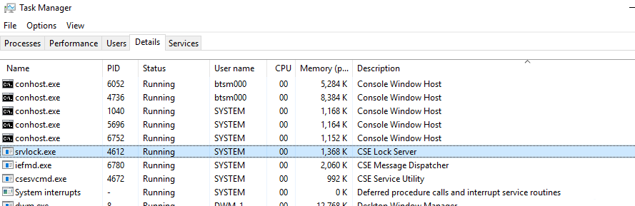

The CSE service CSESvcMD only starts csesvcmd.exe, iefmd.exe and one srv* process srvlock.exe, instead of the usual 7 srv*.exe processes srvcons.exe, srvcoord.exe, srvid.exe, srvlock.exe, srvms.exe, srvuga.exe, srvvc.exe i.e.
Encyclopedia Client will also not connect to the Message Dispatcher and just hangs with no messages.

The srvlock.exe is the only CSE srv*.exe process that does not connect to the Oracle DB, so the implication is that the DB connection is failing for the 6 srv*.exe processes that do connect to the Oracle DB.

3a. In this particular scenario, the sqlplus connection to the remote DB failed with "ORA-01017: invalid username/password; logon denied".
However the Oracle 12c client sqlplus.exe on the same machine could connect successfully using the same parameters to the remote DB.
b. Gen support initially suggested contacting Oracle Support, but then found similar symptoms reported here: https://community.oracle.com/tech/apps-infra/discussion/4313265/11-2-0-2-0-client-connecting-to-19c-gets-ora-01017-unless-it-has-a-10g-password
The root cause seems to be password version i.e. the ORA-01017 logon error from 11.2.0.2 client seems to occur when password version 10G is missing. This SQL run by DBA can be used to check password versions: SELECT USERNAME,PASSWORD_VERSIONS FROM DBA_USERS WHERE USERNAME ='ENCY';
Using the Oracle 12c client sqlplus.exe and a DBA account executed SQL to ALTER the password for user ENCY but kept the same password: ALTER USER ENCY IDENTIFIED BY ...
That was enough to add the '10G' password version.
The Oracle 11g client sqlplus.exe connection test was then successful and the CSE service CSESvcMD also started successfully with all 7 srv* processes starting.
