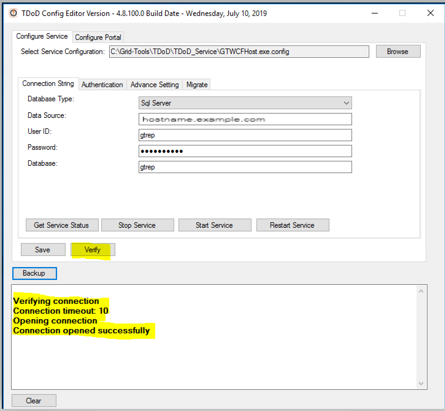

  1. Open a Windows File Explorer and navigate to where TDoD is installed. The default location is C:\Grid-Tools\TDoD\TDoD_ConfigEditor
  2. Launch the TDoDConfigEditor.exe
  3. In the "Configure Service" tab. This tab is used to configure the connection to the gtrep database.
  4. In the "Connection Sting" tab, ensure the correct gtrep DB connection information is entered here.
  5. If any changes were made, click the "Save" button.
  6. Click the "Verify" button to verify the connection to the gtrep database.
  7. Click the "Get Service Status" to verify if the service is running or not. If changes were made, you will need to restart the service before the changes will take effect.
  8. Select the "Configure Portal" tab
  9. Update the "Service URL" field to use the correct hostname. Note, the port will remain the same: 8090.
  10. Click the "Save" button
  11. Click the "Verify" button
    Note: If you haven't integrated TDM with ALM, then the error related to ALM Service is expected and can be ignored.

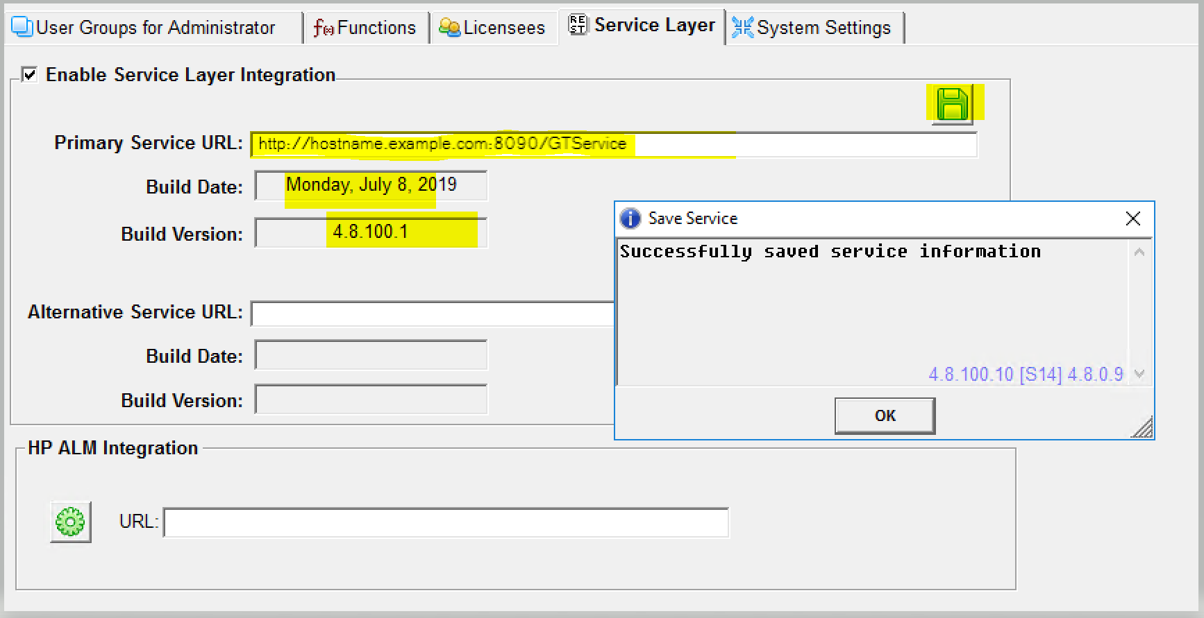

For GT Datamaker:
  1. Launch GT Datamaker
  2. Once logged in, go to the Security tab. You will be asked to log in again.
  3. Under "Users and Groups" select the "Service Layer" tab
  4. Modify the Primary Service URL to reflect the hostname or IP address change. This will be the same URL configured in the TDoD Configuration Editor - Configure Portal tab - Service URL field that we verified above.
  5. Click the Save button.
  6. You should see the Build Date and Build Version fields populated if successful.
